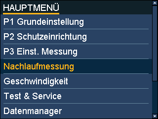

      Hello to all,
      We updated from 5.36 to 5.50 recently.
      In 5.36 the GUI_BMP_Serialize() instruction works fine.
      With 5.50 the colors of the resulting Bitmap are pretty faulty, they have way to much of green color.
      We downgraded the software to 5.36: Colors are correct again.
      What can we do to use the latest version?
      Andy
    • Hi Sven,
      attached you find:
      a) your required files
      b) example of Screenshot correct with 5.36 und a faulty screenshot with 5.50
      Unfortunately I am unable to provide you a demo example. What hardware should I use?
      My whole project would definitely not compile in your environment....
      So the thing is very simple:
      The instruction GUI_BMP_Serialize() can not be configured with parameters. There is nothing I can do wrong on my side.
      The fault is perfectly reproduceable: 5.36: OK 5.50 not OK
      I would therefore suggest, that you quickly test the GUI_BMP_Serialize() instruction in your working environment, which shouldn´t be a big deal at all.
      best regards to you
      Andy

      thanks, I*ll give it a try.
      I meant something like a single-file-example which show how you serialize the screen and save it. Not a complete project.
      Anyhow, I think the information you have provided are sufficient.
      Sven
