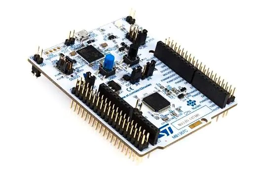

    today I received a new board from ST (STM32G474 Nucleo-64). It contains a new debugging front-end called STLink v3.
    I could not convert the STLink to J-Link using the existing tool, which I reckon is only for STLink v2 ;( .
    "Preparing for FW update (can take up to 10 seconds)...ERROR: Cannot find an ST-LINK, multiple ST-LINKs plugged in, or ST-LINK is in use"

    I must have been one of the first users then!
    I bought it at Mouser :
    nl.mouser.com/ProductDetail/ST…vJTDTT%2FJyROByOTyeQMSnwm
    I really like the new chip STM32G4 for its signal processing capabilities so that was why I wanted to get one for evaluation.
    As you can so in the picture, the top of the board has a BGA chip which is an STM32F723. The debug link is a USB HS type.

    The G4 Nucleo board has a separate mini SWD connector that (through a converter) can be attached to my regular JLink-Pro, So, even when the conversion utility is not ready yet, the board can be used with a standard JLink.
