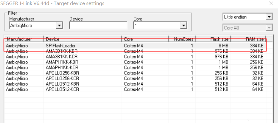

    I want to use ambiq programming spi flash,I get .elf by SES.
    but there is a problem:
    1. Type "connect" to establish a target connection, '?' for help
    2. J-Link>connect
    3. Please specify device / core. <Default>: AMA3B1KK-KBR
    4. Type '?' for selection dialog
    5. Device>?
    6. Please specify target interface:
    7. J) JTAG (Default)
    8. S) SWD
    9. T) cJTAG
    10. TIF>S
    11. Specify target interface speed [kHz]. <Default>: 4000 kHz
    12. Speed>
    13. ****** Error: Error while loading flash algo ELF file: C:\Program Files (x86)\SEGGER\JLink_V644d\Devices/AmbiqMicro/AmbiqMicro_Apollo3_spi.elf
    14. No valid device has been selected.
    15. J-Link>
    JLinkDevices.xml:
    1. <Device>
    2. <ChipInfo Vendor="AmbiqMicro" Name="SPIFlashLoader" WorkRAMAddr="0x10000000" WorkRAMSize="0x60000" Core="JLINK_CORE_CORTEX_M4" />
    3. <FlashBankInfo Name="SPI Flash" BaseAddr="0x00000000" MaxSize="0x800000" Loader="Devices/AmbiqMicro/AmbiqMicro_Apollo3_spi.elf" LoaderType="FLASH_ALGO_TYPE_OPEN" />
    4. </Device>
    help,please!

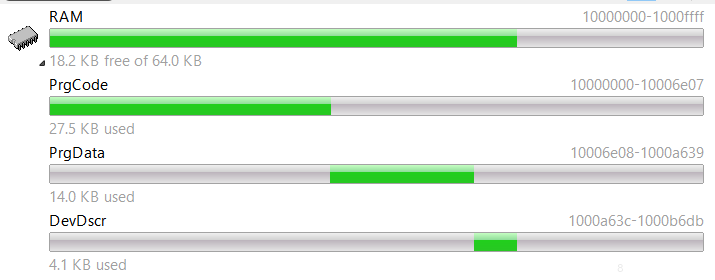

  • hi
    Open_Flashloader has a template projects OpenFlashloader_CortexM_Template_EmbeddedStudio.zip,
    but it has an issue:
    it can not include standard libraries
    I compile project and it has a problem when I add my code into project
    I modify Placement_release.xml below then compile ok and I can get .elf!
    1. <!DOCTYPE Linker_Placement_File>
    2. <Root name="RAM Section Placement">
    3. <MemorySegment name="RAM">
    4. <ProgramSection alignment="4" load="Yes" name="PrgCode" keep="Yes"/>
    5. <ProgramSection alignment="4" load="Yes" name="PrgData" keep="Yes" inputsections="*(PrgData PrgData.* .data .data.*)"/>
    6. <ProgramSection alignment="4" load="Yes" name="DevDscr" keep="Yes"/>
    7. </MemorySegment>
    8. </Root>
    I put *.elf into C:\Program Files (x86)\SEGGER\JLink_V644d\Devices\AmbiqMicro
    I changed JLinkDevices.xml at C:\Program Files (x86)\SEGGER\JLink_V644d
    I want to use jlink.exe to connect,but "****** Error: Algo error: EraseSector algo function has not been implemented No valid device has been selected."
    help,please!
    thanks!

    From your screenshots it seems that you are trying to write a QSPI flash loader for an Apollo3 device from Ambiq. Is that correct?
    If yes make sure that when creating a new entry in the JlinkDevices.xml all target specific connect, reset, init etc. steps that are not ARM standard need to be done e.g. via a JLinkScript file.
    As you can see in the entry for the AMA3B1KK-KBR there is a JLinkScript specified that takes care of some target specific initialization.
    If you are looking to add QSPI support to e.g. that device simply expand the existing entry with your new flash bank.
    This could look as follows:
    1. <Device>
    2. <ChipInfo Vendor="AmbiqMicro" Name="AMA3B1KK-KBR" Core="JLINK_CORE_CORTEX_M4" JLinkScriptFile="Devices/AmbiqMicro/AmbiqMicro_Apollo3.pex" />
    3. <FlashBankInfo Name="QSPI Flash" BaseAddr="0x00000000" MaxSize="0x00800000" Loader="Devices/AmbiqMicro/example.elf" LoaderType="FLASH_ALGO_TYPE_OPEN" />
    4. </Device>
    However we do not recommend using BaseAddr 0x0 as this would effectively overwrite the Flash mapping of the internal Flash of the Apollo3 which would render that Flash unusable in your configuration.
    The external SPI space is at 0x04000000 according to the Apollo3 manual.
    All other questions are answered in the open Flash loader Wiki article.
