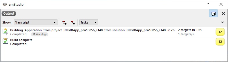

I am using (SEGGER Embedded Studio for ARM, Release 4.12 Build 2018112601.37855, Windows x64) and there are 3 things that I noticed that I would would like some help with/suggestions. The first 1 item is obviously significantly more important.
1) When I compile and there are warnings it requires 2 or 3 mouse clicks to actually view the warnings. You can see what I get in the first attachment. I have looked, and I can not find a setting to automatically expand warnings as well as errors. Nor can I find a key that would take me to the first warning/error.
