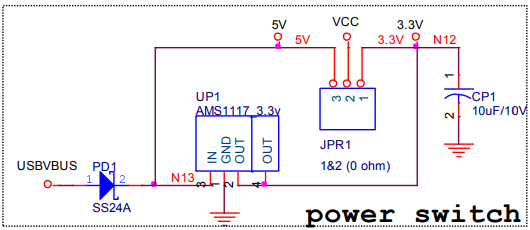

I want to develop programs on Nuvoton N76E003AT for a small project. I never programmed this chip before. Below is the link to the Nuvoton direct for an evaluation board;
direct.nuvoton.com/en/nutiny-n76e003

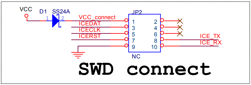

I checked the schematic and datasheet . It looks like Nu-Link-Me is the debugger which runs over SWD port. I want to ask at this point: Is it possible to use J-Link EDU to debug and program Nuvoton's N76E003 over SWD?
IMHO minimal connection (w/o SWO) should be as follows;
J-Link Pin-1 (VtRef ) ..... JPR1 Pin-3 On dev.board (if MCU is supplied from 5V, Pin-1 for 3.3V)
J-Link Pin-7 (SWDIO) ..... JP2 Pin-3 On dev.board(ICEDAT)
J-Link Pin-9 (SWCLK) ..... JP2 Pin-5 On dev.board(ICECLK)
J-Link Pin-15 (RESET) ..... JP2 Pin-7 On dev.board (ICERST)
J-Link Pin-8 (GND) ..... JP2 Pin-9 On dev.board(GND)
Link to datasheet : nuvoton.com/resource-files/UM_…DK-N76E003_EN_Rev1.01.pdf
Best regards!
