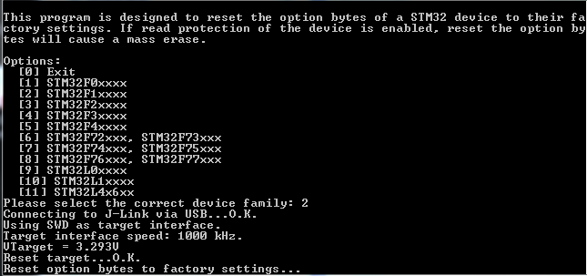

    hi,
    I have a firmware which works on stm32f103c6 .
    We had to replace the controller with an other to get more space for the flash Rom and that was the stm32f103cbt6,they are the same familiy and have the same datasheet and everything is the same .
    when i try to flash it (using Jtrace Pro) i get first a messaeg that active write protected stm32 device detected and asks me if i want to perform an unlock . I click yes and i get error "could not stop cortex-M device please check the jtag cable.
    i have already tried :
    - unlock kinetis in jlink commander but i got "Timout while unlocking device" (screenshot below)
    - reset the option bytes to factory settings but it stucks without any feedback (screenshot below)
    everything was ok with the old STM we just replaced it with new one ,nothing has changed !!
    Thanx alot for any help
    unlock kinetis is meant to be used by NXP Kinetis devices, not ST target devices. Please do not use this command on any ST devices, as this could lead to unpredictable behaviour.
    This should not new necessary if you never changed the opt bytes on your new target devices.
    Did you program the opt bytes at some point?
    How are you flashing your application?
    Could you provide a J-Link log of a Flashing session?

  • Hello Nino,
    thank you very much for your answer and sorry it was my mistake ,the controller was not good soldered on the board and somehow stucks in reset state forever .
    Now everythig run perefctly .
    Thanx again.
