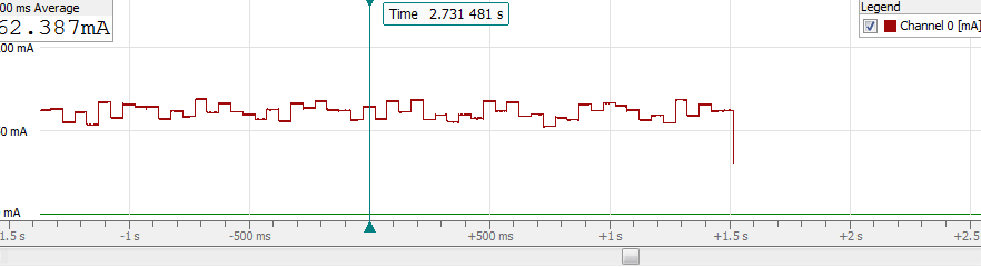

    So, I have a need to analyze my power consumption on a Cortex-M3 and need some guidance on proper setup.

        1. When running my target I see just a couple of spikes but mostly 0mA?

    Generally the steps you took look correctly.
    I just tried to reproduce the issue with out Cortex-M Trace Reference Board and our embOS start project (LEDs blink there so it is easier to see that something is happening in the power graph) and everything was working as expected. See attached picture.
    The only thing I can imagine goes wrong here is that the target device is not fully powered by the J-Link alone.
    What is the typical current draw of your target device if you power it with a bench power supply?
    Is the 5V-Supply pin the only one supplying the target device? segger.com/products/debug-prob…gy/interface-description/
    All external power supplys that might power the target device must be unplugged.
    Are you using a custom board or an eval board?
    Could you provide an excerpt of the schematics showing the debug interface and its wiring?

  • Hi Nino,
    Thanks for the reply.
    So, I was able to get this working, not sure exactly what the issue was.
    I did a couple of things that may or may not have "fixed" it.
    • I reset my J-Link Pro configuration (via J-Link Configuration)
    • I recalibrated using J-Link Commander (via "calibrate" command)
