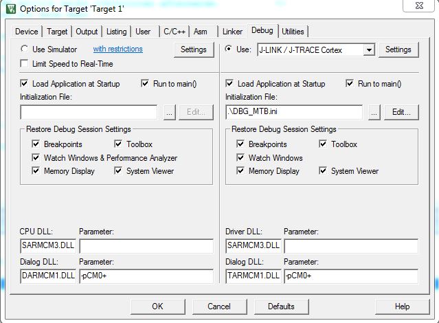

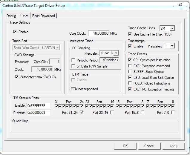

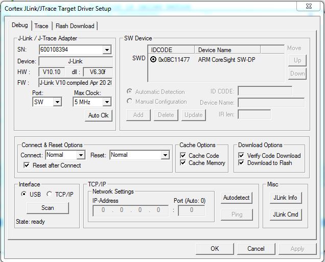

    I am trying to setup traces using our company's cortex-m0+ MCU having MTB capability.
    I have setup the following:
    1. Created MTB.ini file containing the MTB SRAM size and MTB address fields for my device.
    2. Setup Keil MDK with the project to be debugged. I have setup the debug tab with appropriate parameters as displayed below:
    3. Whenever I debug the program it gives me an error "Trace HW not present"
    Can you please tell me what the problem is? I have read up different blogs and forum articles for connecting Jlink with MTB and followed the procedure.
