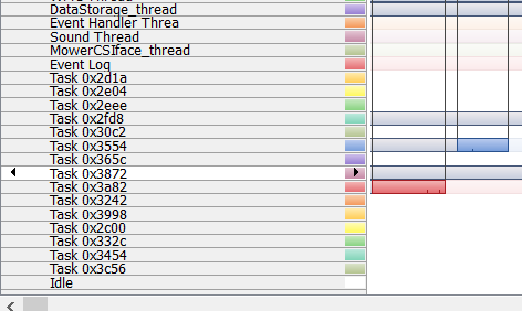

    I'm trying out the SEGGER SystemViwer (evaluation) on our system which consists of several FreeRTOS threads. When I look at the timeline view, events view, etc. only a few task names are shown with its real name the others are anonymous like Task 0x30C2.
    The recordings runs over RTT with no reported overflows or lost packages. The FreeRTOS10 is setup with the SystemViewer instrumentation including the patch.
    Do I need SystemViewer PRO to be able to show all task names or what can I do about it?

    Here is how it looks like... some threads have name, but most of them don't. All threads are created with a name string present.

    Due to certain limitations by FreeRTOS, SystemView needs to memorize task names externally on its own.
    Per default 8 task names will be buffered.
    To increase this value go to the SEGGER_SYSVIEW_FreeRTOS.h and edit entry SYSVIEW_FREERTOS_MAX_NOF_TASKS to the number of tasks you need.
    After that all task names should show up.
    Does this solution work for you?
    We will improve our manual in that regard.
