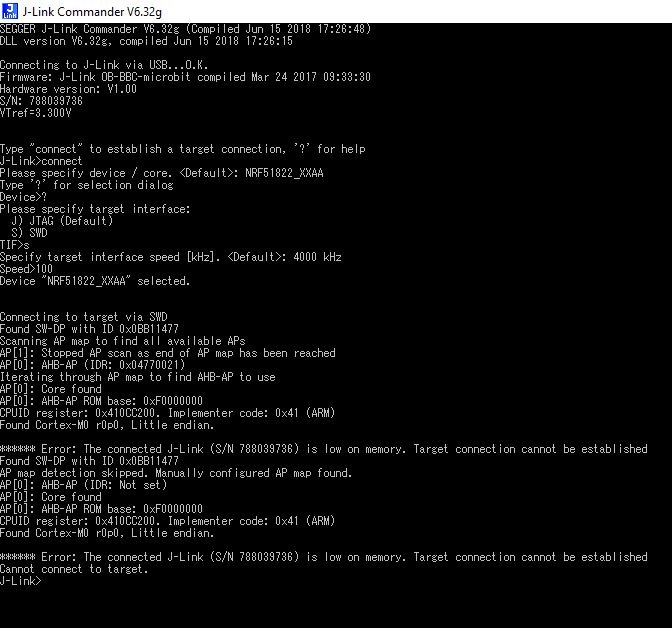

    I am using segger embedded studio for nordic board nrf52 board had no problem.
    However, when I testing with the micro:bit segger jlink, it failed.
    Connecting ‘J-Link’ using ‘USB’
    Connecting to target using SWD
    Loaded C:/Program Files/SEGGER/SEGGER Embedded Studio for ARM 3.40/bin/JLink_x64.dll
    Firmware Version: J-Link OB-BBC-microbit compiled Mar 24 2017 09:33:30
    DLL Version: 6.32c
    Hardware Version: V1.00
    Target Voltage: 3.300
    Device "NRF51822_XXAA" selected.
    Found SW-DP with ID 0x0BB11477
    Scanning AP map to find all available APs
    AP[1]: Stopped AP scan as end of AP map has been reached
    AP[0]: AHB-AP (IDR: 0x04770021)
    Iterating through AP map to find AHB-AP to use
    AP[0]: Core found
    AP[0]: AHB-AP ROM base: 0xF0000000
    CPUID register: 0x410CC200. Implementer code: 0x41 (ARM)
    Found Cortex-M0 r0p0, Little endian.
    The connected J-Link (S/N 788039736) is low on memory. Target connection cannot be established
    connect failed
    Failed to connect to target.
    No idcode detected.
    Please check connection and Target Interface Type
    I also used Keil 5 for the setup and the micor:bit board gave me the error:
    No Cortex-M SW Device found.
    The message copied as follow:
    JLink info:
    DLL: V6.32g, compiled Jun 15 2018 17:26:15
    Firmware: J-Link OB-BBC-microbit compiled Mar 24 2017 09:33:30
    Hardware: V1.00
    S/N : 788039736
    * JLink Info: Found SW-DP with ID 0x0BB11477
    * JLink Info: Scanning AP map to find all available APs
    * JLink Info: AP[1]: Stopped AP scan as end of AP map has been reached
    * JLink Info: AP[0]: AHB-AP (IDR: 0x04770021)
    * JLink Info: Iterating through AP map to find AHB-AP to use
    * JLink Info: AP[0]: Core found
    * JLink Info: AP[0]: AHB-AP ROM base: 0xF0000000
    * JLink Info: CPUID register: 0x410CC200. Implementer code: 0x41 (ARM)
    * JLink Info: Found Cortex-M0 r0p0, Little endian.
    ***JLink Error: The connected J-Link (S/N 788039736) is low on memory. Target connection cannot be established
    Error: Flash Download failed - Target DLL has been cancelled
    Flash Load finished at 22:01:44
    Please help if there is any setting wrong.
    Kan.

  • Hi Nino,
    Thanks for your prompt and helpful reply.
    I followed the wiki and here is the output:
    I am using both segger embedded studio and keil with no other third party software.
    The same cable and setup using official Nordic board with no issues.
    However, micro:bit is my target platform.
    Good to know that it works with micro:bit but I still have no luck.
    Please help.
    Kan.

  • Hello Kan,
    On our side the issue was not reproducible on the micro:bit board. So from J-Link perspective everything is working as expected.
    Please understand that we can't put much time into this matter as from our side everything is working.
    When setting up your device did you follow this guide? segger.com/products/debug-prob…-microbit-j-link-upgrade/
    Could you provide a J-Link log of the failing sequence? wiki.segger.com/Enable_J-Link_log_file
    Did the micro:bit work at any point?
    Is some application already running in the target device?
