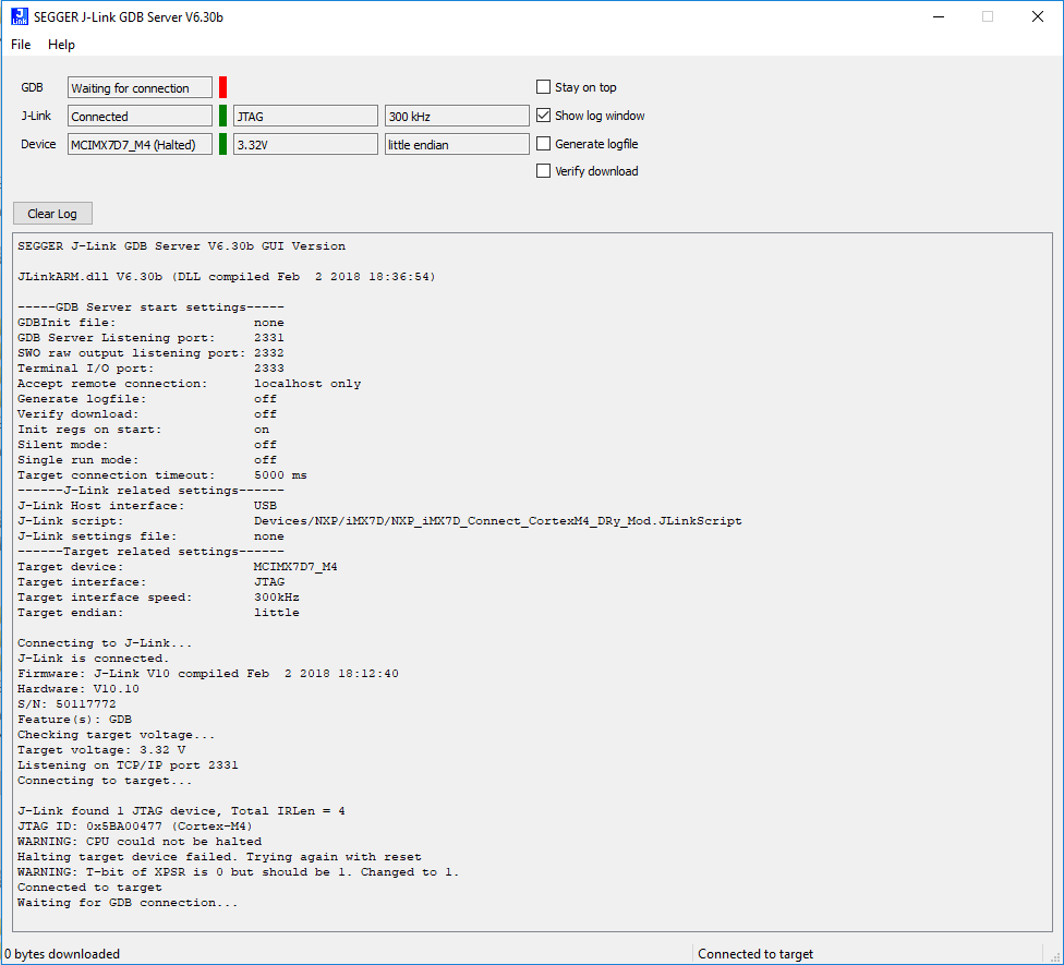

  • I have found out how to add a script file based on wiki.segger.com/Eclipse
    This is the output for the SABRE board:
    ------J-Link related settings------
    J-Link Host interface: USB
    J-Link script: C:\Eclipse_MCU_And_Toolchains\JLink\File_NXP_iMX7D_Connect_CortexM4.JLinkScript
    J-Link settings file: none
    eature(s): GDB
    Checking target voltage...
    Target voltage: 3.33 V
    Listening on TCP/IP port 2331
    Connecting to target...ERROR: Error while compiling J-Link script file: Error while compiling. Line 1, column 8:
    <!DOCTYPE html>
    Pragma unknown
    Bad JTAG communication: Write to IR: Expected 0x1, got 0xF (TAP Command : 10) @ Off 0x5.
    Could not find core in Coresight setup
    Ant output for our custom board (giving a different error):
    Target voltage: 1.81 V

  • The JLinkScript you are using, is it from the J-Link software install folder?
    I used a downloaded the version from your wiki page. I checked the content of the downloaded version ... it was actually a web page and not a script so I probably screwed up the file download.
    Switched to the script in the install folder.
    Did you modify the JLinkScript in some way?
    Nope.
    What J-Link software version are you using in Eclipse?
    First console output in OP:
    SEGGER J-Link GDB Server V6.22g Command Line Version
    JLinkARM.dll V6.22g (DLL compiled Jan 17 2018 16:39:42)
    should be the latest version. Was downloaded a few days ago._____________________________

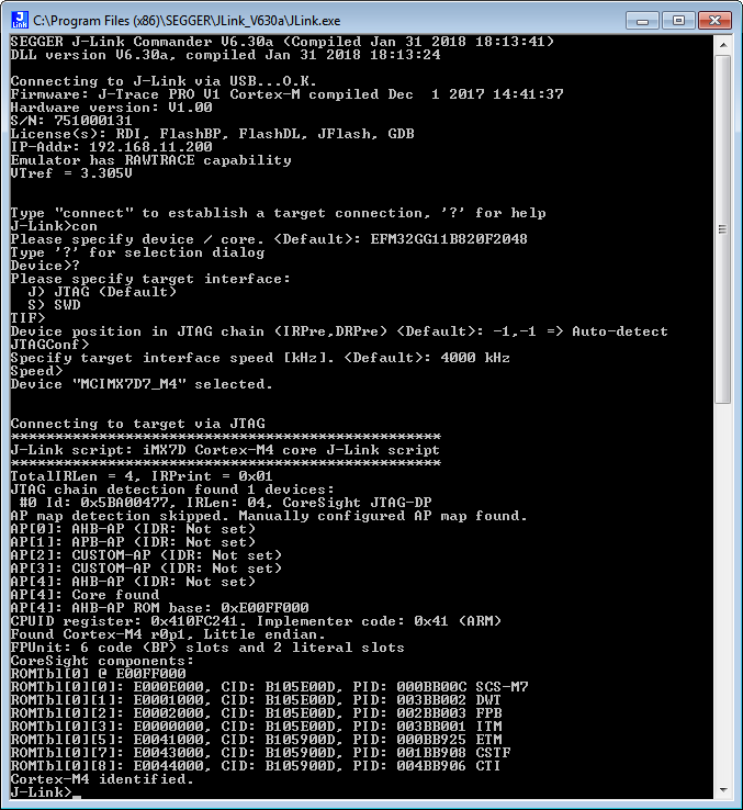

    Connecting via JLink.exe and not through Eclipse:
    SABRE:
    Speed>300
    Device "MCIMX7D7_M4" selected.
    Connecting to target via JTAG
    J-Link script: iMX7D Cortex-M4 core J-Link script
    TotalIRLen = 4, IRPrint = 0x01
    JTAG chain detection found 1 devices:
    #0 Id: 0x5BA00477, IRLen: 04, CoreSight JTAG-DP
    AP map detection skipped. Manually configured AP map found.
    AP[0]: AHB-AP (IDR: Not set)
    AP[1]: APB-AP (IDR: Not set)
    AP[2]: CUSTOM-AP (IDR: Not set)
    AP[3]: CUSTOM-AP (IDR: Not set)
    AP[4]: AHB-AP (IDR: Not set)
    AP[4]: Skipped. Could not read CPUID register
    AP[4]: Skipped. No ROM table (AHB-AP ROM base: 0x00000000)
    ****** Error: Bad JTAG communication: Write to IR: Expected 0x1, got 0xF (TAP Command : 10) @ Off 0x5.
    CUSTOM:
    Specify target interface speed [kHz]. : 4000 kHz
    Speed>300
    Device "MCIMX7D3_M4" selected.
    AP[4]: Core found
    AP[4]: AHB-AP ROM base: 0xE00FF000
    CPUID register: 0x410FC241. Implementer code: 0x41 (ARM)
    Found Cortex-M4 r0p1, Little endian.
    FPUnit: 6 code (BP) slots and 2 literal slots
    CoreSight components:
    ROMTbl[0] @ E00FF000

    I am wondering ... do I need to run the scripts for A7_0, A7_1 and M4 one after another? Or is it okay to run only the M4 script file?
    You only need to run the M4 Script file to connect to the M4.
    Attached is the J-Link Commander output I get with our SABRE board.
  • With the script provided in the NXP Forum thread mentioned in my previous post I am able to have the JLinkGDBserver connect to the M4, waiting for the GDB connection.
    So I think this part is all good now. I just dont know how to get the GDB connection up.
    When I started the JLinkGDBServer through the win command prompt and then start e debug sesion in eclipse, the session is started. But i do not see any debug output. Or any other hint for the system to be alive.
    The post was edited 1 time, last by LHE ().
