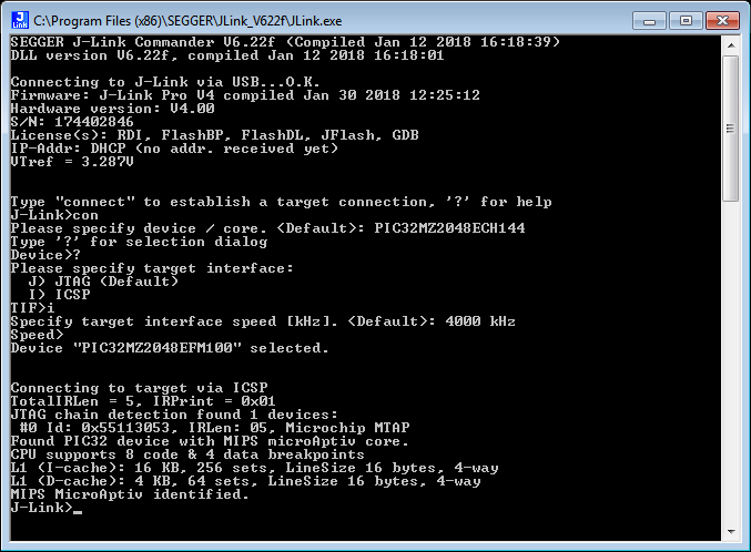

  • Hello Patryk,
    I used Michrochip eval board: "PIC32MZ Starter Kit".
    Unfortunately most Microchip OB debug chips have bugs when trying to use external debug probes.
    It will trigger random chip resets and other signals even when JP2 is removed.
    What might work is to desolder the OB completely from the board to make sure it does not interfere with the debug probe.
    To avoid this issue I recommended using the Explorer 16 Development Board and our Microchip adapter.
    Attached is a successful connect to the device. Erase, reset, write, read etc. all work as well.
    So as I said before this is no J-Link issue but strictly a hardware related one. Compare your hardware to the Explorer 16 board and try to mimic the debug connection.
    For more information about the Microchip hardware contact Microchip support.
    From our side everything is working as intended.
