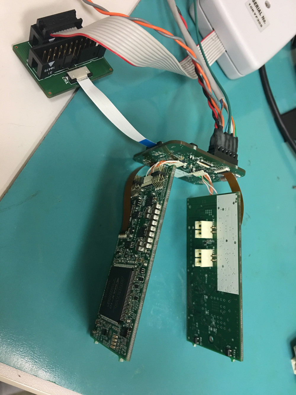

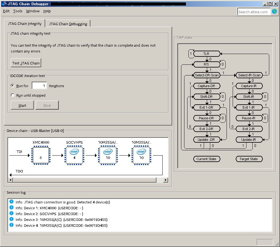

    My circuit design has one infineon XMC4800 mcu and two intel MAX10FPGA(10M25SA) in one JTAG chain.
    JTAG TDI => XMC4800 => 10M25SA => 10M25SA => JTAG TDO
    I can program FPGAs with USB Blaster but I can't program XMC4800 with J-link Ultra+.

  • Another my PCB works.
    Hello Nino,
    I designed two XMC4800 boards.
    The one is only XMC4800 as JTAG device. but I have the board which connected FPGA and chained in same JTAG chain by FPC.
    I attached schematics about only JTAG connection (reason is open space here).
    [MCU0 design]
    J-link works OK.
    JTAG shematic of MCU0 board
    MCU0.pdf
    [MCU1 & two FPGA design]
    One MCU1 boards are connected with two FPGA boards by FPC.
    Quartus prime works OK to program FPGAs.
    J-link fails.
    JTAG schematic of MCU1 board
    MCU1.pdf
    JTAG schematic of GPA board
    FPGA.pdf
    If MCU1 is not connected with FPGA board. Then I can use SWD method to program. But I need to use JTAG method.
