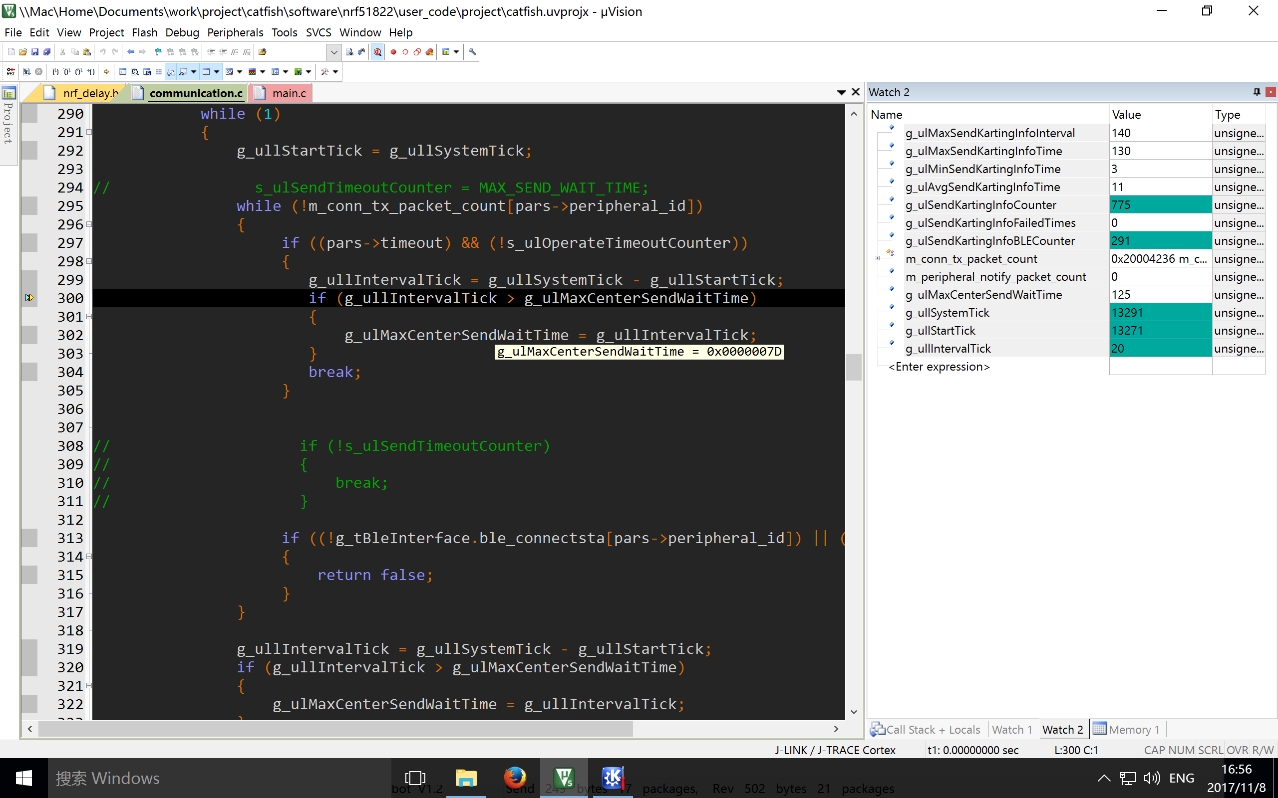

    I debug this program, found g_ulMaxCenterSendWaitTime always be 0, and I know that's clearly wrong,it's definitely not going to be 0. So i set a breakpoint at
    1. if (g_ullIntervalTick > g_ulMaxCenterSendWaitTime)
    , and i found g_ullSystemTick(the value is 1220) is larger than g_ullStartTick(the value is 1200),but g_ullIntervalTick still equal 0!I don't know what went wrong.
    The variables is global variable and use 'volatile' qualifier, and only this function use there variables. My project setting is, Code > Code Generation > Optimization Level set to Debug,Code > Code Generation > Debugging Level set to level-3.
    I run this code in keil MDK,very thing is OK.
    I don't dare use SES now because i don't know when there will be weird problems even my code work well in keil MDK before.
    Is there any way to solve the problem?

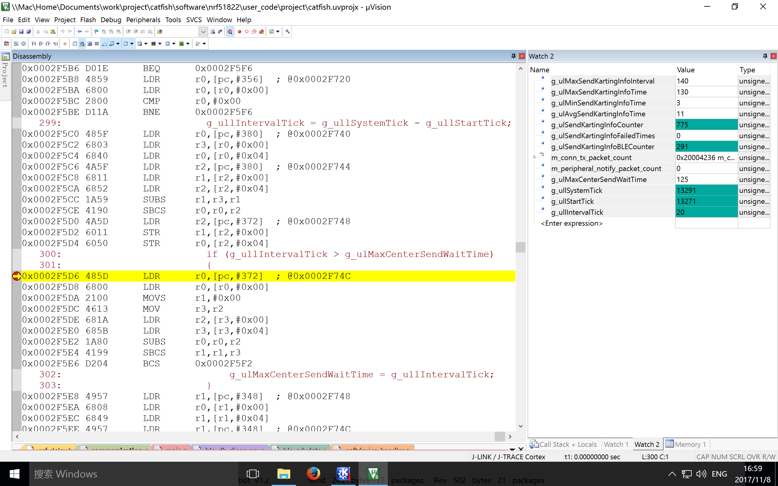

  • The attachment is screenshots when use keil MDK
