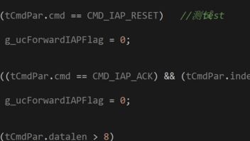

    I am Chinese, so there are many Chinese comment in my code,then i found SES has poor support for Chinese,it seems like just because One Chinese character requires two spaces and SES only give it only one space.There are two pictrues, one is what my code looks like in keil MDK, another is it looks like in SES:
    This is probably due to the fact that the text file encoding set in your project does not support Chinese symbols.
    To change this go to Tools->Options->Text Editor->International->Default Text File Encoding
    Now simply choose a standard that contains Chinese symbols and you are good to go.

    I tried set ' Tools->Options->Text Editor->International->Default Text File Encoding' to UTF-8, and also set 'Project' and 'Solution'->code->file->file Encoding to UTF-8, it does't work.Then I tried set them to GBK and GB2312, it also dons't work. I tried this when i first met this problem few weeks ago actually, i just tried again last night.
    So,what can I do now? Or maybe you should check whether this is the problems of SES i think.
    We are currently looking into this and are certain that the issue can be resolved. Could you provide us with an example file that includes the characters in question so we can reproduce that issue?
    We found a solution for the Chinese symbols.
    Go to Tools->Options->Text Editor > Visual Appearance > Font Rendering and select "Proportional".
    Now the spaces should be rendered correctly.
