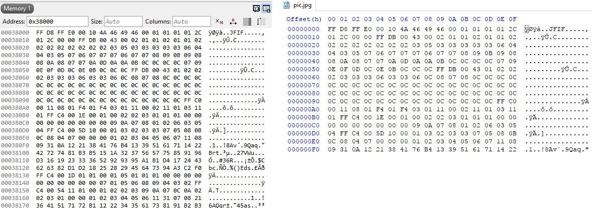

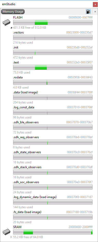

  • Thanks to you both! Here's my result. I have used a JPG file instead of a WAV file.
    First, I checked the memory size and usage not to overlap my binary file.
    So I configured the load file after checking the memory usage.
    After flashing the MCU with the J-Link, the memory viewer shows the correct values! I used HxD to check the binary values.
    Case solved! Thanks1
