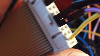

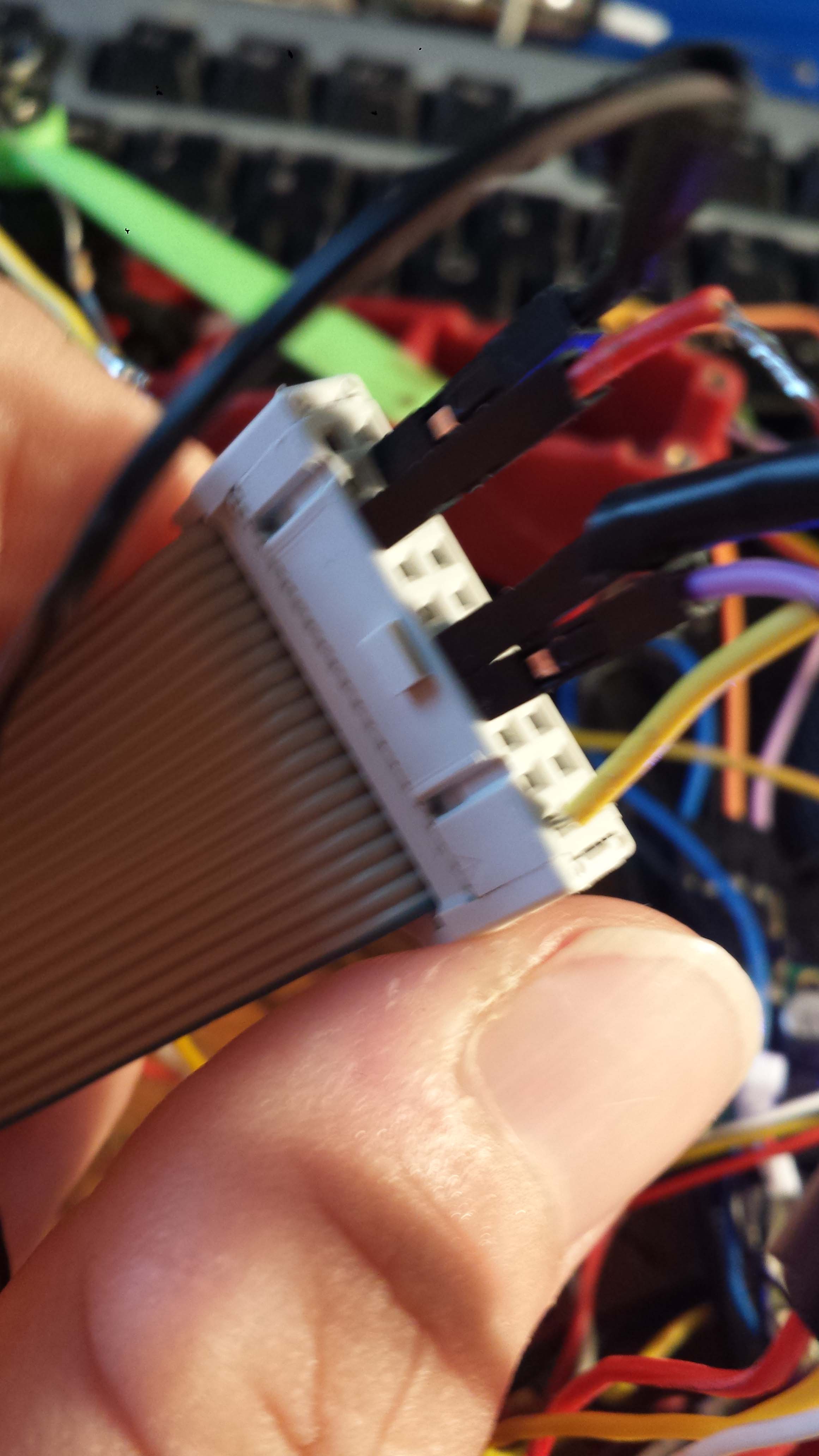

  • Nick,
    SEGGER - Niklas wrote:
    The image shown on the mentioned page describes the 20 pin pinout on the J-Link side.
    The pinout in the linked document is definitely correct and used by us and our customers.
    For easier reference, the pinout is also available on the website: segger.com/products/debug-pr…ion/#tab-4031-2
    I am a customer too and it does not appear to be correct. I looked at link above and it looks to be the same diagram as in the pdf that I originally used. Perhaps the unit I have is faulty/the internal connections are miswired? Perhaps they switched something in the newest edu version?
    I attached a picture of the j link cable i am using on the drone side. Note the notch on the left side of the connector. Also note, there is nothing connected to the upper most left pin of this connector. I assume this is pin 1, vtref. I tested that the upper left most pin, with regard to the notch being on the left when looking down on the connector, is connected and not reverses in the cable. It connects to the same pin on the other side.
    In any case, the other side of the connector in this picture plugs into the j link edu and it works. I tested the go/halt instruction with the TestHaltGo command.
    I will look into using the mem commands you described.
    I am using eclipse as it was on the page that originally pointed me to the j link edu debugger.
    I might try ozone after I get the eclipse plugin to work. Though this is fun so far, especially now after the j link edu appears to work, I've spend a lot of time installing things and reading up on serial debug stuff than i originally thought.
    Thanks for the help,
    Jeff
  • Hi Jeff,
    Sorry for the confusion, there seems to be a misconception:
    With the phrase "20 pin pinout on the J-Link side" I am referring to the male connector on the J-Link unit.
    The pinout on the female cable is not the same!
    Imagine connecting it to an eval board like this one:
    wiki.segger.com/images/a/a2/STM324x9I.jpg
    (The 20 pin connector is located on the right edge below the Ethernet port)
    In order to connect Pin 1 of the J-Link to Pin 1 of the board, the cable is facing downwards. (While the cable is plugged in, you cannot see the ports of the cable)
    Therefore, the "polarity protection nibble's" position is reversed on the cable.
    Hint: - on the male connector on J-Link and eval boards, VTref is located in the top right corner (if the polarity protection slot is on the left side)
    On the cable, the VTref side is marked blue on the ribbon cable.
