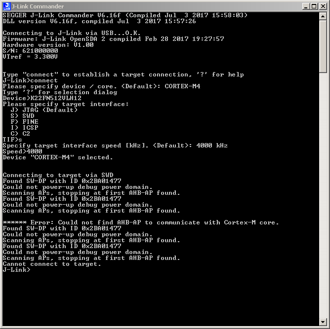

    Are you sure with the device-string? I’m getting an error with it (see the picture attached)
    Markus
  • Hi Markus,
    sorry for the typo.
    Please give MK22FN512VLH12 a try.
  • Hi Markus,
    My second Board is also not working anymore. Same behavior, it stopped working after a debug session. The software to debug crashed at some point, and ended up with a board which does to respond to the debugger anymore.
    This sounds like the target application leads to a state where J-Link cannot connect to the target device, for example low power modes, disabling / alternate use of the debug pins, etc...
    The designated fallback in this case is to use the reset pin and to perform a connect under reset, which is what J-Link attempts to do according to the log output, but the procedure fails.
    Could you please check if the reset pin is connected?
    What kind of target application or you trying to debug?
    Would it be possible for you to provide us with a target application which could be used for reproduction purposes?
