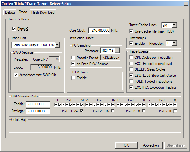

    Hello all,
    I get "Trace HW not present" error on STM32H743 using J-Trace Debugger. With ST-Link V2 trace works correctly as expected. Trace with STM32F7 also worked fine for both Segger and ST-Link.
    Any ideas?

  • Hello Marcus,
    thank you for your inquiry.
    What kind of trace are you using? ETB, SWO, ETM?
    I ask, because the ST- Link V2 only supports SWO and ETB trace.
    What are your KEIL Trace settings, could you show me a screenshot of your project setup?
    Regarding the STM32H743 device and ETM Trace we are already in contact with ST because we had some troubles getting streaming trace up and running on the evaluation boards they send out to us.
    So if your issue is related to the one we are experiencing internally, there is no fix known to us at the moment to enable ETM trace.
    Should you be using ETM trace, could you try to verify with an oscilloscope if the trace clock is being output on pin 12 of the trace debug header?
    If yes, is data being output on pins TD0-TD3 (pint 14-20) ?
    Should neither, or only the clock be outputted, there seems to be an issue with the GPIO setup of the trace pins, which your IDE should usually take care of.

  • Hi Nino,
    in the first step I wanted to use SWO, also because I did not want to risk slowing down the execution. Of course, I would also like (and probably have) to use ETM later on. Thanks for the hint at your wiki trace page. Attached please find the screenshot of the trace configuration.
    Kind regards
    Marcus
  • Hello Marcus,
    the Keil settings look correct on the first view.
    Are you using the same connector/interface for the ST-Link and J-Trace?
    I am asking, because on the H7 evaluation board the JTAG/SWD and trace connector have the SWO pin wired differently (even wrong on the trace connector side), also the interface pins are not wired correctly on the trace connector.
    So in the case of the evaluation board, using the classic JTAG/SWD connector should output SWO, but the trace connector will not.
    Could you check that on your hardware please? Here is a link how it would be wired correctly: segger.com/interface-description.html

  • Hi Nino,
    with Ozone I used the axf file. According to the Ozone setting I used:
    J-Link Settings:
    Traget Interface
    SWD: 5 MHz
    Trace configuration:
    - Trace Port
    - 4 Bit
    With this, I assume I used ETM. However, SWD sounds like I used SWO ... !?
    - Marcus
  • Hello Marcus,
    - Trace Port
    - 4 Bit
    If "Trace Port" is selected you are definitely using ETM for tracing now with all available 4 data pins. SWO is just an optional feature of SWD.
