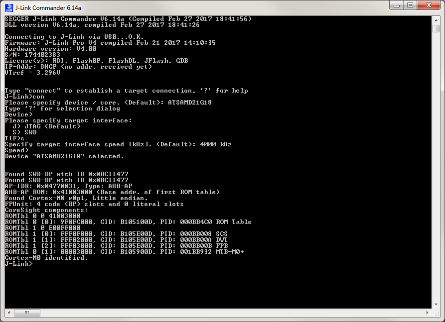

    when using a SAMW25 Xplained Pro, the connect works, therefore I assume support of ATSAMD21 devices works.
