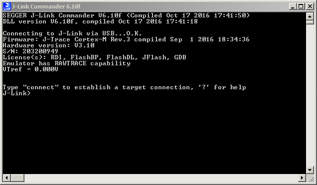

  • Hi Markus,
    could you please open J-Link Commander and take a screenshot? Example:
    Could you provide us with the exact label of the MCU?
    There exist some revisions of the K60 which have no setup time for the trace data signal (= TRACE_CLK and TRACE_DATA are changed at the same time).
    Unfortunately, 0M33Z is buggy hardware revision.
    Tracing will not work reliable with this unit.
    Regarding the Ozone license:
    The unit was produced 2010-08-12. 6 years ago, the "J-Link Pro Software bundle" was not bundled, but an optional purchase (~500€).
    In order to upgrade to a J-Trace with the required license, I recommend to make use of the SEGGER Trade-In Program, which would give you a credit of 498€ towards your next purchase. Therefore, a new J-Trace Cortex-M would be 498€ (instead of 995€), and a new J-Trace Pro Cortex-M would be 893€ (instead of 1390€).

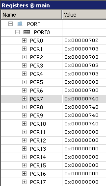

  • Hello Niklas,
    I took a closer look to the Registers of the K80 Board. It looks like the debugger initialized the GPIO-pins incorrect.
    It initializes the Pins PTA6 – PTA9 as trace Pins, but on this board PTA12 – PTA16 is used for trace. I didn’t found a way to configure the pins in ozone, so I tried to configure it in my program. Sadly that didn’t work.
    Any Idea how to configure the pins?
    Markus

  • Hi Markus,
    you are correct, the J-Link Software currently configures PTA06-PTA10, which is not available on all pin-out options of the K80.
    However, activating the pins in the target software or via Ozone worked fine for me.
    Could you please replace the AfterTargetReset function in your Ozone project file with the following code and provide feedback if it works for you?
    1. /*********************************************************************
    2. *
    3. * AfterTargetReset
    4. *
    5. * Function description
    6. * Event handler routine. Optional.
    7. *
    8. **********************************************************************
    9. */
    10. void AfterTargetReset (void) {
    11. Target.WriteU32(0x40048038, 0xFFFF); // System Clock Gating Control Register 5 (SIM_SCGC5): Enables Clock for PORT A-E, TSI, LPTMR1, and enables software access to the Low Power Timer module.
    12. Target.WriteU32(0x40048004, 0x00001000); // System Options Register 2 (SIM_SOPT2): TRACECLKSEL (Debug trace clock select) : 1 == Core/system clock
    13. Target.WriteU32(0x40049030, 0x00000400); // Select ALT Mode 4 of Pin A12 (Trace_CLKOUT)
    14. Target.WriteU32(0x40049034, 0x00000440); // Select ALT Mode 4 of Pin A13 (Trace_D3) and enable High drive strength
    15. Target.WriteU32(0x40049038, 0x00000440); // Select ALT Mode 4 of Pin A14 (Trace_D2) and enable High drive strength
    16. Target.WriteU32(0x4004903C, 0x00000440); // Select ALT Mode 4 of Pin A15 (Trace_D1) and enable High drive strength
    17. Target.WriteU32(0x40049040, 0x00000440); // Select ALT Mode 4 of Pin A16 (Trace_D0) and enable High drive strength
    18. }
  • Hello Niklas,
    Thanks for the scripts. With this extension it is working with my board. It is setting the alternative Pin configuration for the trace pins, but still keeps the original
    one:
    I already tried to deactivate the old pins by extending your code:
    1. void AfterTargetReset (void)
    2. {
    3. Target.WriteU32(0x40048038, 0xFFFF); // System Clock Gating Control Register 5 (SIM_SCGC5): Enables Clock for PORT A-E, TSI, LPTMR1, and enables software access to the Low Power Timer module.
    4. Target.WriteU32(0x40048004, 0x00001000); // System Options Register 2 (SIM_SOPT2): TRACECLKSEL (Debug trace clock select) : 1 == Core/system clock
    5. Target.WriteU32(0x40049030, 0x00000400); // Select ALT Mode 4 of Pin A12 (Trace_CLKOUT)
    6. Target.WriteU32(0x40049034, 0x00000440); // Select ALT Mode 4 of Pin A13 (Trace_D3) and enable High drive strength
    7. Target.WriteU32(0x40049038, 0x00000440); // Select ALT Mode 4 of Pin A14 (Trace_D2) and enable High drive strength
    8. Target.WriteU32(0x4004903C, 0x00000440); // Select ALT Mode 4 of Pin A15 (Trace_D1) and enable High drive strength
    9. Target.WriteU32(0x40049040, 0x00000440); // Select ALT Mode 4 of Pin A16 (Trace_D0) and enable High drive strength
    10. Target.WriteU32(0x40049018, 0x00000000); // Select ALT Mode 0 of Pin A6
    11. Target.WriteU32(0x4004901C, 0x00000000); // Select ALT Mode 0 of Pin A7
    12. Target.WriteU32(0x40049020, 0x00000000); // Select ALT Mode 0 of Pin A8
    13. Target.WriteU32(0x40049024, 0x00000000); // Select ALT Mode 0 of Pin A9
    14. Target.WriteU32(0x40049028, 0x00000000); // Select ALT Mode 0 of Pin A10
    15. }
    Which is not working, also resetting it in the Register-View of Ozone is not working, as the debugger is activating the original configuration immediately.
    Markus
