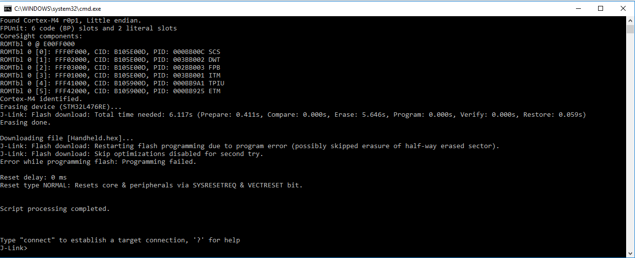

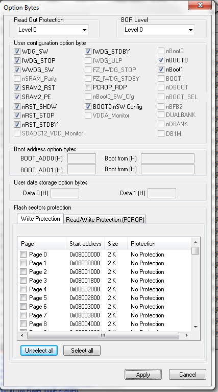

  • STM32L476RE - Flash sector 2 locked after writing
    Hi Niklas,
    Using the last J-link suite V6.10i I had problems writing the 2nd FLASH sector (0x08040000-0x0807FFFF) of a STM32L476RE.
    After many tests it seems as the 2nd sector is "locked" after the first write.
    In fact, I write and erase a piece of code on FLASH sector 1 how many times I want (standard behavior of a debug session).
    If I try to write the same code on the 2nd sector, after the very first time it isn't possible to erase and rewrite it again.
    After this, the processor FLASH can be "unlocked" only using the JlinkSTM32 utility.
    Do the write-erase sequences with the J-Link Commander leads to the same results.
    I investigated also on FLASH_OPTR, WPR and PCROP status after writing, but nothing seems to write-protect the FLASH sector 2.
    Maybe this is an hidden issue of the Flash programming Algo?
    Thank you in advance for investigating it.
