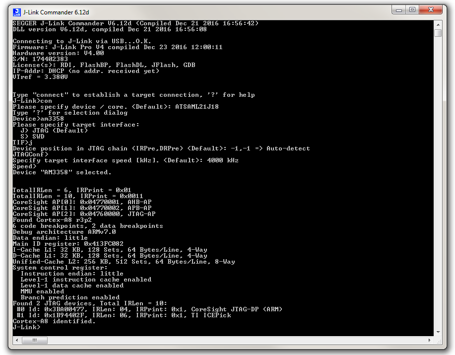

    i have a beaglebone black (rev-c) and i also have j-link EDU .. when connecting using the command
    JLink.exe -device am3358 -if JTAG -speed 4000
    or
    JLink.exe -device am3359 -if JTAG -speed 4000
    i got following error
    SEGGER J-Link Commander V6.00f (Compiled Aug 11 2016 18:36:38)
    DLL version V6.00f, compiled Aug 11 2016 18:36:04
    Firmware: J-Link V9 compiled Aug 3 2016 18:50:44
    Hardware version: V9.30
    S/N: 269307960
    License(s): FlashBP, GDB
    OEM: SEGGER-EDU
    VTref = 1.023V
    Type "connect" to establish a target connection, '?' for help
    J-Link>connect
    Device position in JTAG chain (IRPre,DRPre) <Default>: -1,-1 => Auto-detect
    JTAGConf>
    Device "AM3358" selected.
    TotalIRLen = ?, IRPrint = 0x..000000000000000000000000
    ****** Error: AM335x connect: Can not find ICE-Pick (IRLen mismatch)
    AM335x connect:Can not find ICE-Pick (IDCODE mismatch). Expected 0x0B00002F, found: 0x00000000
    Cannot connect to target.
    i have searched the in internet but can't find any solution and i can understands what is the error.
    i also tried to start BBB without booting from eMMC by using boot button but i got always the same.
    I just gave it a try an connecting to a BBB using your settings (JTAG, 4000kHz) works fine for me. (Screenshot attached)
    VTref = 1.023V
    This is suspicious to me, i would guess 1V is too low.
    Could you please check the power supply you are using for the board?
    I used a "generic" center positive 5V 1.5A power supply.

    which device do you want to connect to?
    Please type in device name and not the core name when asked for the device.
    Are you sure you can connect to the core via JTAG? Or does it maybe only have SWD connected?
    I am sorry to hear that you are still experiencing issues.
    I just gave it a try and it works fine:
    Therefore, I can only assume that either there is sth. wrong with the wiring or that the CPU is in a secured / ultra-low power etc. state in which it cannot be debugged.
