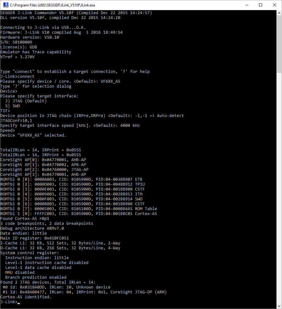

  • We've checked different versions of J-Link Software. On versions older than 5.10g all work fine, but since 5.10g J-Link can't connect to Vybrid controller (see attachments). Moreover, version 5.10f can connect to the Vybrid controller only if I manually specify IRPre = 10 and DRPre = 1, auto mode doesn't work.

    thanks for this information.
    I will take a look at the difference between 5.10f and 5.10g.
    EDIT: Fixed typ0.
    please find attached a J-Link script file. Could you please give it a try?
    You can start J-Link commander using: "JLink.exe -JLinkScriptFile Freescale_Vybrid_AccessA5.JLinkScript.txt"
    There is no need to configure the device position, everything is set up in the script file.
    Arne
    did you change your hardware setup?
    Your last screenshot showed TotalIRLen = 14, while the current one shows TotalIRLen = 24.
    You can change the values for JTAG_IRPre and JTAG_DRPre in the script file according to your hardware setup.
    Arne
