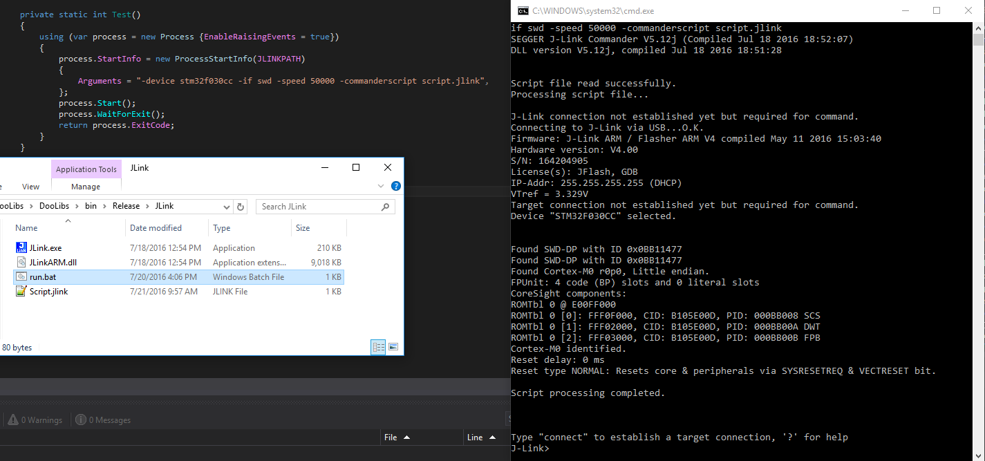

    Good morning!
    We have recently made the switch from an STLink flasher that was VERY unstable to a Flasher ARM and so far our initial testing leaves us very satisfied, thank you for a solid product.
    Now, here is the steps we took since receiving the Flasher ARM :
    -Program via JFlash. Worked.
    -Program via JLinkExe, in console. Worked.
    -Program via JLinkExe with a batch file and argument -commanderscript. Worked.
    -Program via JLinkExe with argument -commanderscript launched by C# code. Not Working.
    I am about certain the code i wrote to launch and handle the process, not open a console window, redirect its output, etc. is working as i have tested it with other executables (notably STLink CLI).
    But I will accept you doubting this and so i went ahead and tried with the bare minimum code i could use to start the process, and it still does not program.
    I am using the exact same arguments and jlink script as the batch file scenario which works.
    Its hard to identify possible causes of the problem since every exitcode has been 1. Even when trying to introduce different errors such as unplugging the Flasher or unplugging the target.
    For this issue refer to this post : JLinkExe return code 1 when executing script
    The script.jlink file is the same used for both this and the batch file , it contains only an "r" to shut the target board down for now.
    The batch file that works :
    1. JLink.exe -device stm32f030cc -if swd -speed 50000 -commanderscript script.jlink
    Here is the test method with code as simple as possible to start the process :
    ok i give up trying to keep this sample formatted right, previewing the post keeps messing it up, im sorry...
    i left it visible in the screenshot of the batch file output.
    1. private static readonly string DIRECTORY = Path.Combine(Environment.CurrentDirectory, @"JLink\");private static readonly string JLINKPATH = Path.Combine(DIRECTORY, "Jlink.exe");
    2. private static int Test(){ using (var process = new Process {EnableRaisingEvents = true}) { process.StartInfo = new ProcessStartInfo(JLINKPATH) { Arguments = "-device stm32f030cc -if swd -speed 50000 -commanderscript script.jlink" }; process.Start(); process.WaitForExit(); return process.ExitCode; }}
    I added a screenshot of the batch file console output, the test method only flashes the screen but does not shut down the target board.
    I will try switching the procress to cmd.exe with a /K argument to keep window open today and report back but here is the output i get when running my other method which redirects the JLinkExe output :
    [DEBUG]Launching Jlink.exe
    SEGGER J-Link Commander V5.12j (Compiled Jul 18 2016 18:52:07)
    DLL version V5.12j, compiled Jul 18 2016 18:51:28
    [DEBUG]Process ended, exit code : 1

    thanks for your inquiry.
    Can you please verify this by using MS Process Explorer (standalone / portable tool, enhanced task manager) ?
    If you double click on a processes, it gives you this window, which contains the command line arguments.
    PS:
    Additionally, could you try if this issue also occurs if you specify a full, not a relative path? e.g. "C:\temp\script.jlink" instead of "script.jlink" .
    PPS:
    I am out of the office for today, I will be back tomorrow .
  • Hi Niklas,
    I have downloaded the software as advised and could never get a hit on the process ran programatically because it would exit instantly.
    But once i added the absolute path for the script file it finally started staying open and i noticed that the "current directory" is set to my software exe's directory instead of \JLink\ one step deeper!
    So it is now working but isn't it counter intuitive that i have to give JLinkExe arguments relative as to where the current directory is rather than where IT is when launched? oO

  • Hi Phil,
    Relative Paths are interpreted as relative to the current working directory, not the location of the application launched.
    As for as I know, this has been the default for all programs I know, for all "important" operating Systems (MS Windows, macOS, Linux/Unix, FreeBSD).
    The script i was running was "r loadfile ~~~ r g exit". Which i would've expected to break instantly considering the Flasher was not connected to the target board.
    J-Link Commander is a development tool. We know that it is used in some automated / production scenarios, but we can not "endorse" this and strongly recommend to use J-Flash for production grade programming.
    J-Link Commander's return value depends on whether the last action executed(which sometimes is not the last command given by the user) returned success or fail.
    However, we introduced a command "eoe 1"/ command line switch "-ExitonError". When set, J-Link Commander will exit if an action fails and return 1 in order to indicate that an error has occurred.
