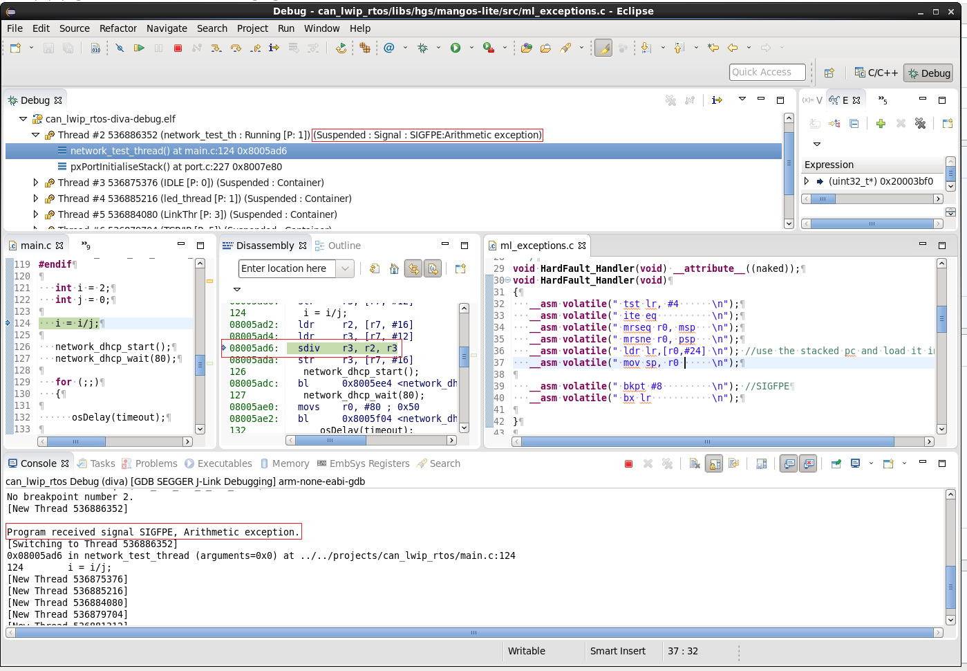

  • Hi Arne,
    I tested the binary you supplied. It's perfect!
    For a test, I hardcoded the SIGFPE (#8 ) Signal which is shown in the debugger view in eclipse. perfect!
    after the excpetion, the pc points at the exact instruction which caused it. perfect!
    it is do be discussed what amount of exception identification can be done on the target / gdb server.
    I find your suggestion with different "bkpt #X && bx lr" combinations great.
    during the last weeks, you winded up the quality of embedded debugging by a huge leap, congratulations for that! I really like the results of it!
    your interaction with this forum is remarkable and very welcome at our side :)
    hope this Proof of Example can find its way into one of the next stable versions.
    Best Regards
    Peter
