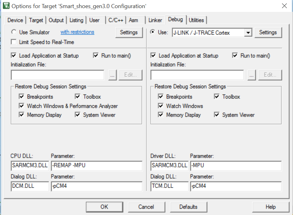

    I am trying to load code onto a STM32F401RBT6 using KEIL µVision V5.18a with a J-Link EDU, and am getting the J-link - Cortex-M error: "No Cortex-M SW Device Found."
    The green light on the J-Link is lit. When I go to the project options, it says that the device is an STM32F401RBTx (there is no option for STM32F401RBT6). I'm wondering if this is the issue?
    I have attached a screenshot of the device and debug options.
    Any help would be appreciated!

    could you give J-Link Commander a try?
    J-Link commander is part of the J-Link software package, which is available free of charge here .
    • Start J-Link Commander (jlink.exe)
    • Type "connect" in order to start a debug session
    • Type in the target device name if asked (Or type "?" for a target selection Dialog)
    • Choose the correct target interface (JTAG/SWD/etc..)
    • Use a valid speed (Default: 4000kHz, try 100-500 if default does not work)
    • [JTAG only]]JTAG conf can be default(most of the times)
    • You should now be successfully connected.
    If anything fails, could you post a screenshot of the complete session?

  • Hi Cara,
    VTref = 1,032 V seems very low. Could you check the power supply of the target device?
    How is the target powered?
