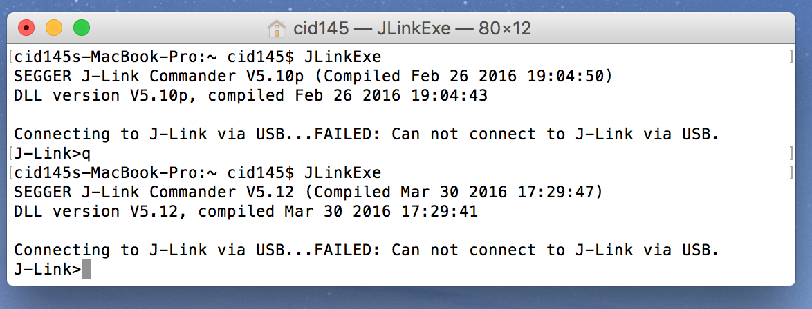

    if you install the new version of the J-Link software it will replace the current version.
    Example:
    (I installed 5.12 in-between the two JLinkExe calles)
