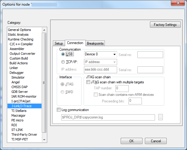

    according to the Log file, SWD is selected as interface in IAR:
    1. T1AA4 023:017 JLINK_TIF_Select(JLINKARM_TIF_SWD) returns 0x00 (0003ms, 0021ms total)
    Could you please select JTAG and give it a try?
  • Unfortunately, as you can see below, that option is disabled in the settings, and I don't know why. I have tried changing a couple other settings to see if the option would get enabled, but without success. I'm using IAR 7.60.1.
    EDIT: In case you want me to try JTAG in J-Link Commander, here's a log (I tried both SWD and JTAG earlier, but only posted the SWD log):
