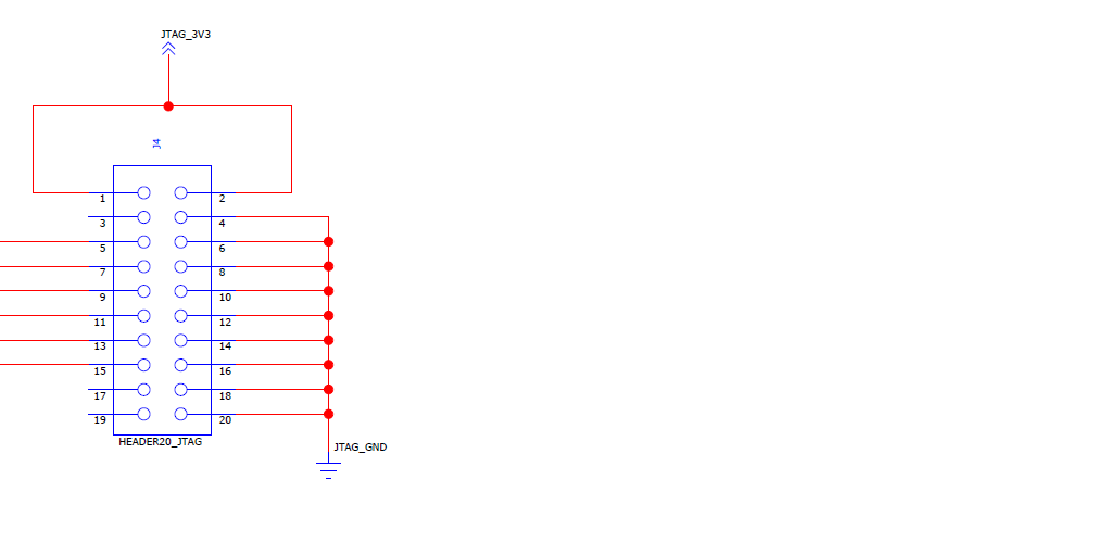

    I have to mention that I was told to measure the voltage across the JTAG pins. So I did it, and pins 1 and 2 show a zero voltage. I am really new to this domain, I was told that I may have damaged the board given that there is no voltage on those pins. I have attached a schematic of the pins from the board's user manual. My question is how do I know for sure that the board is damaged? I have opened a ticket with Atmel, who made the board, and waiting for their response at this point. My board also has a mini JTAG, which I do not have the converter for. What is your advice at this point? I am going to purchase another board if this is damaged, but I like to know for sure. Is there any way to repair the board?

    please understand that we cannot offer support for non SEGGER-Products like the board. I cannot tell you whether its broken or how to repair it.
    You confirmed that VTref = 0.00V by using an external tool (e.g. Voltmeter), therefore I assume your issue is not J-Link related.
    Regarding on why VTref could be 0.00V: Could be anything: Wrong power supply, broken device / board, wrong jumper settings.....
    I would suggest to measure VTref on the mini JTAG using a Voltmeter.
