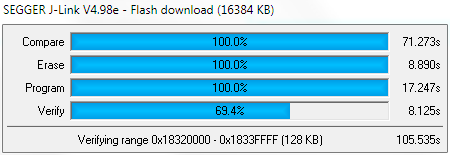

  • I have tested today the v500i and is working with a good speed improvement, see attached images,
    just one minor issue: with v498e from jlink commander was possible to erase the flash with command erase:
    J-Link>erase
    Erasing device (R7S721001)...
    Info: J-Link: Flash download: Total time needed: 150.412s (Prepare: 3.187s, Compare: 0.000s, Erase: 144.718s, Program: 0
    .000s, Verify: 0.000s, Restore: 2.505s)
    Erasing done.
    now with the v500i the command does nothing:
    J-Link>erase
    Erasing done.
    Toni.
  • Hi Toni,
    Thank you for the positive feedback!
    In the old version, flash programming was support for one specific QSPI flash only. Versions >= 5.00 uses the generic QSPI flash programming support which allows to program any cummon QSPI flash conencted to the R7S721001. As customers may connect any peripheral to the SPI pins (they are not forced to use them for the QSPI flash), we are not allowed to toggle the QSPI pins in order to determine if a flash is connected and if so which type / size.
    Anyhow, we have already on our ToDo list to add a command which allows customers to explicitly enable erase for particular flash banks. Unfortunately, I can not provide any fixed time schedule for this right now as we are busy with some other projects.
