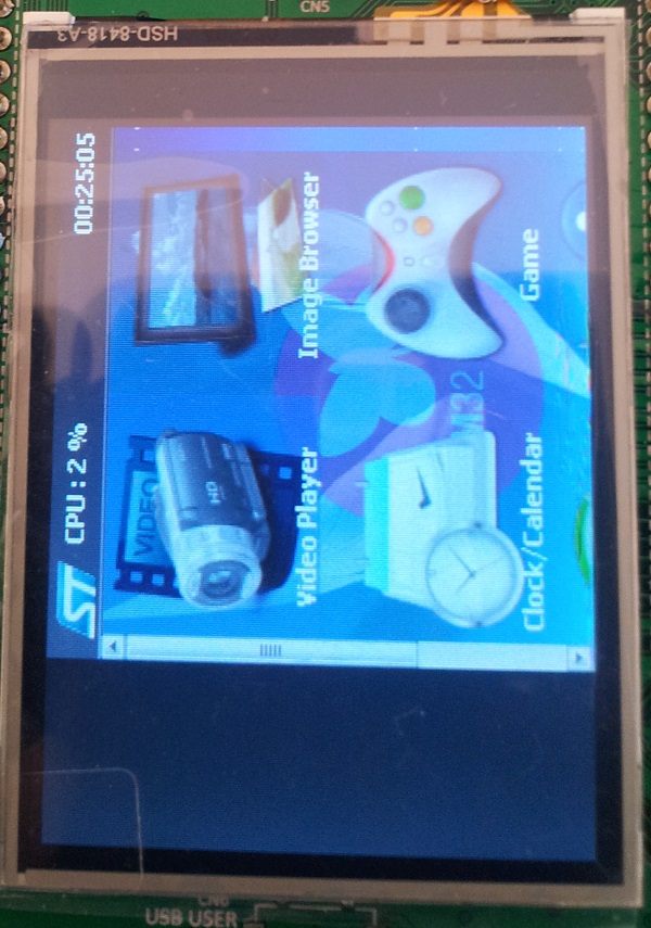

    I'm using stm32F429 Disco and StemWin+ LTDC (Lcd ILI9341)
    Lcd Driver -> GUI_DEVICE_CreateAndLink(GUIDRV_LIN_32, GUICC_M8888I, 0, 0);
    when changing rotation of 180 degrees all works Ok
    Lcd Driver ->GUI_DEVICE_CreateAndLink( GUIDRV_LIN_OXY_32, GUICC_M8888I, 0, 0);
    I need to change the rotation of the LCD by 90 degrees
    I try to use this driver
    GUI_DEVICE_CreateAndLink(GUIDRV_LIN_OSX_32, GUICC_M8888I, 0, 0);
    but it does not work.
    Does anyone know how to change the rotation by 90 degrees

  • I'm experiencing same problem as in smashings original question. I'm using STM32F429 discovery hardware and STemWin's Hello world example application from STM32Cube_FW_F4_V1.1.0 package as a base for my tests.
    I have put some texts, bitmaps and rectangles to the screen as a test. Everything works correctly when I use GUIDRV_LIN_32 driver as is in the example.
    Rotating screen 180 degrees with use of GUIDRV_LIN_OXY_32 seems ok. But when I take a closer look it's not. Texts and bitmaps are correctly on the screen. Every shape painted with GUI functions is on opposite coordinate even texts and bitmaps are on correct position. So for example GUI_FillRect(10,10,20,20) will be on opposite corner of the screen than bitmap painted with GUI_BMP_Draw((void *)&bmptest, 10, 10). Every painted shape is looking correct but visible on the wrong place.
    Real case is that I need a rotation of 90 or 270 degrees and this is a bigger mess. Texts and bitmaps are still ok but every shape and fill with GUI functions will cause broken graphics when I use GUIDRV_LIN_OS_32, GUIDRV_LIN_OSY_32 or GUIDRV_LIN_OSX_32 driver. It's quite like in smashings photo. Here is mine with some texts and one circle. As you can see all texts are ok and the circle is in three parts. Using OSX or OSY driver will also cause already mentioned coordinate problems. I have also noticed that defining LCD_MIRROR_X or LCD_MIRROR_Y will not change anything. I have also noticed that changing XSIZE_PHYS and YSIZE_PHYS will effect somehow. Using same size for both directions will fix the graphics. For example 240x240 and 220x220 are ok but 240x220 and 220x240 are corrupted.
    Finally... Should it be possible to create landscape screen by only changing the driver from GUIDRV_LIN_32 to GUIDRV_LIN_OSY_32? What could possible explain that texts and bitmaps are all fine but painting shapes or filling/clearing the screen will corrupt the display? What could cause opposite coordinates problem? There shouldn't be a need to change anything in the ili9341 initialization?
    Any ideas are welcome. Thank you.
  • Is it possible that STemWin (should be same as emWin) can cause problem where texts are displayed correctly at the same time as circles are displayed wrongly?
    That don't look like a display driver issue because some stuff is displayed totally ok. As far as I understand the display image is first created to the frame buffer and then transferred to the screen. Transferring data from frame buffer could not anymore separate if content is text or circle - even on same position.
    What can possible cause that writing to frame buffer can be faulty as shown in my picture? Some problem in size definitions?

  • Hi Adrian,
    I've tested STemWin Examples [1] on STM32F429 Discovery with GCC Compiler (EmBlocks 2.30 [2]).
    Original configuration is as follow
    #define XSIZE_PHYS 240
    #define YSIZE_PHYS 320
    #if (COLOR_MODE_0 == _CM_ARGB8888)
    #define COLOR_CONVERSION_0 GUICC_M8888I
    #define DISPLAY_DRIVER_0 GUIDRV_LIN_32
    • Without any modification I get the following result
    • With GUIDRV_LIN_OSY_32 I get the following result
    • With #define YSIZE_PHYS 240 I get the following result
    When I set a screen size less than 240px, screen was displayed as expected, but for size is greater than 240px, screen was corrupted as shown in above image. In my case, It seems that STemWin doesn't support the rotation the size greater than 240px.
    How to rotate screen for its size greater than 240px. Thanks in advance.
